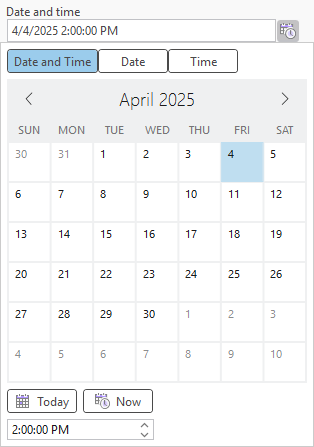

Date
The default control for the Date data type supports date and time, date only, and time only values. The control appears as follows after clicking the Select date and time button Date:
Default Date control

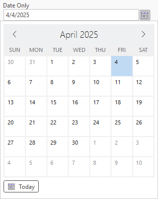

To support a parameter that accepts dates only, use a controlCLSID value of {499BF343-569C-4B2B-864B-742C602C33FE}. The control appears as follows after clicking the Select date button Date Only:
Date only control
