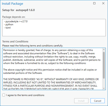

  7. In the package information, click the Install button .
    The Install Package dialog box appears.
    Install Package
  8. After reviewing the terms and conditions, check the I agree to the terms and conditions check box.
    The Install Package dialog box may list dependencies that the package requires. If the packages are not already included in the environment, they will be installed as well.
    The Install button is activated.
  9. Click the Install button.
