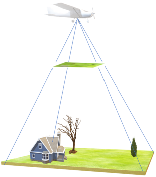

Image mensuration relies on the image-to-ground transformation of a sensor model. For single image mensuration, the transformations require the elevation of the point. The height can be estimated with an average height, but a terrain model will provide more accurate results. The mensuration computation requires image x,y coordinates and a ground z-coordinate. When a terrain model is included, the calculation is iterative, intersecting a ray from the image to the terrain model to determine the point intersection with the ground. In rare instances, particularly in the cases of rugged terrain and high obliquity, the iteration may not result in a valid solution because of ambiguity. In these cases, the system is unable to compute a singular point, resulting in no valid solution.
Hinweis:
It is possible for the measurement methods (point, length, area, and feature height) to not return a value if a solution is indeterminate. It is important to only use image coordinates with this function since map coordinates will first be transformed to image space, resulting in possible error.
Sensors capture a 2D representation of a 3D world.

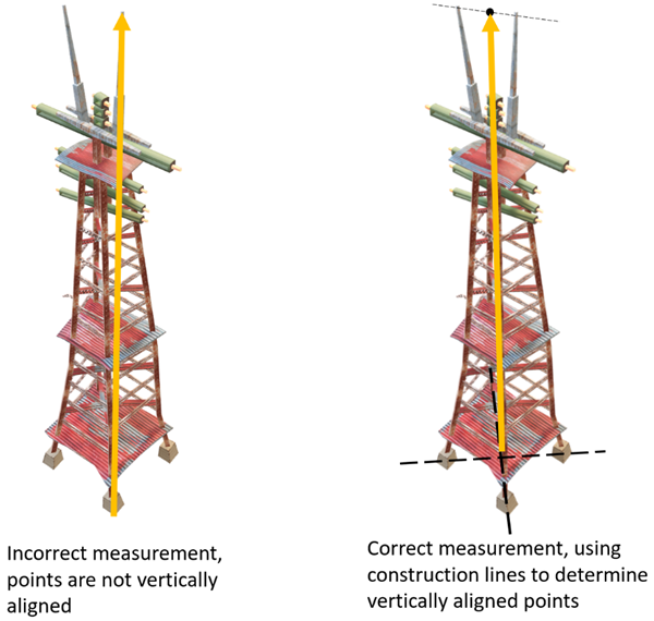

For height measured from the base of an object to the top of the object, it is assumed that the points are vertically aligned, meaning that the lower point is directly below the upper point. For measurements using shadows, sun angle information must be included in the sensor model metadata. It is assumed that an object casts a shadow onto flat terrain that intersects the base of the object at a point that is understood to be the base. If the terrain is sloped, it can either extend or shorten the returned height value.
Making correct height measurements

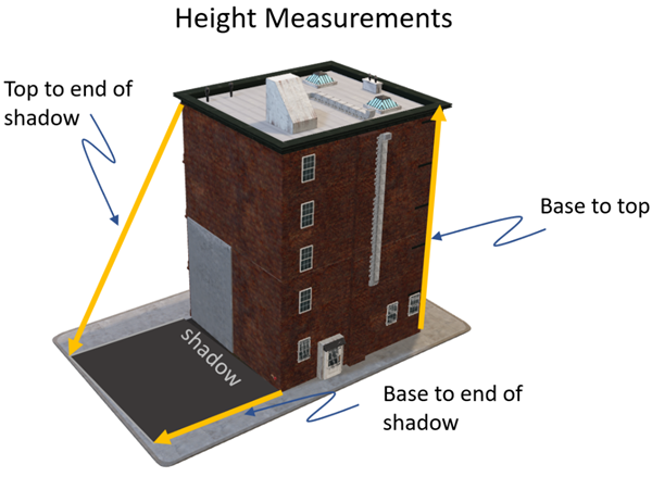

The height calculation is computed on the ellipsoid and does not follow the terrain. It is possible that this method will not return a value if it is unable to converge on a solution. It is important to only use image coordinates (column, row) with this method, as map coordinates will be transformed to image space, resulting in a possible error.
Height measurement
Calculate the height of an object:
import arcpy
raster = arcpy.sa.Raster(raster_path)
mens = arcpy.ia.Mensuration(raster)
result = mens.height((base_x, base_y),
                     (top_x, top_y),
                      Mensuration.base_to_top)
print (f"Height: {result.height} m")

base_to_shadow
(Lesen und schreiben)
Calculates the height of a feature by measuring from the base of the object to the top of the object's shadow on the ground.
Long
base_to_top
Calculates the height of a ground feature by measuring from the base of the object to the top of the object.
Long
top_to_shadow
Calculates the height of a feature by measuring from the top of the object to the top of the object's shadow on the ground.
Long

Height measurements of an object can be obtained when a sensor model exists for an image. Sun angle information is required to make measurements using shadows. The height of an object is calculated between two points, based on a sensor model. Three types of height measurements are supported:
  • base_to_top—Calculates the height of a ground feature by measuring from the base of the object to the top of the object.
  • base_to_shadow—Calculates the height of a feature by measuring from the base of the object to the top of the object's shadow on the ground.
  • top_to_shadow—Calculates the height of a feature by measuring from the top of the object to the top of the object's shadow on the ground.
