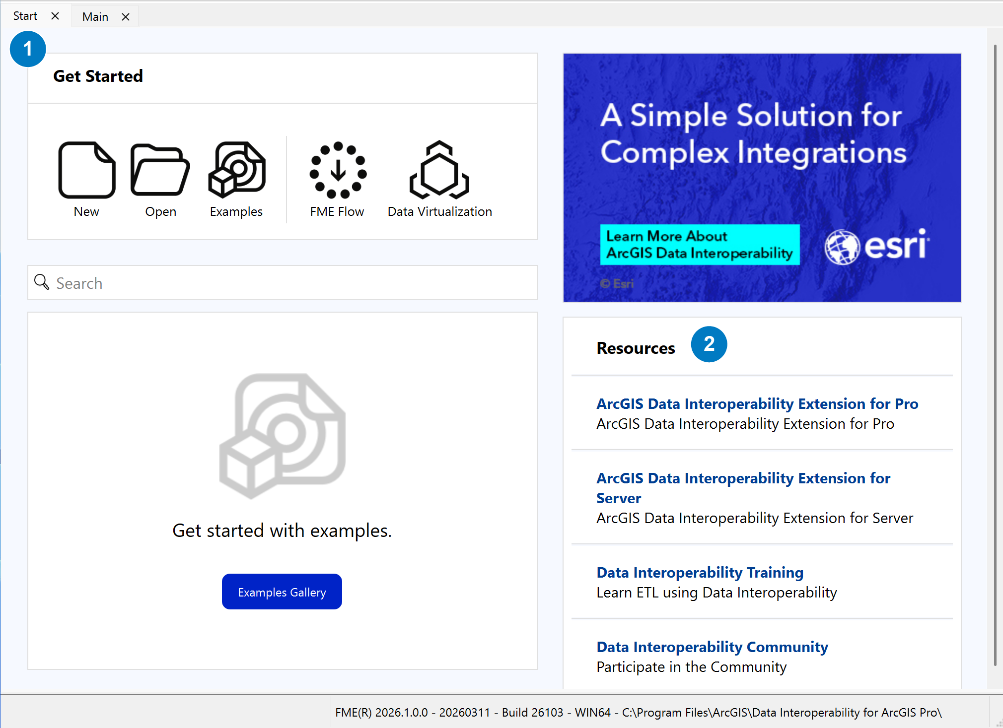

Your first go-to for product help is on the Start tab of the Workbench app. It provides online links to the product resources.
Data Interoperability Resources links
Element Description
1 Click Start tab of the Workbench app
2 Resources pane with links to product help, training resources, and the ESRI Data Interoperability Community place

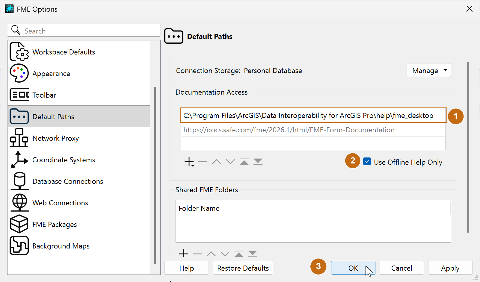

The offline help files are excluded from the setup. If you want to use offline help or do not have an active internet connection, you can change the default help to offline by clicking Utilities > FME Options > Default Paths tab > from the main menu.
Wichtig
Before you can enable the Use Offline Help Only check box, the path to the offline help documentation must appear in the Documentation Access table in the Utilities > FME Options > Default Paths tab.
Follow the configuration steps in Default Paths tab dialog as shown in the image below.
Configure offline help document
  1. To configure the offline help path (see note below) follow similar configuration steps in the online article from Safe Software.
  2. Check the Use Offline Help Only check box.
  3. Click OK at the bottom of the FME Options dialog to save the offline configuration.

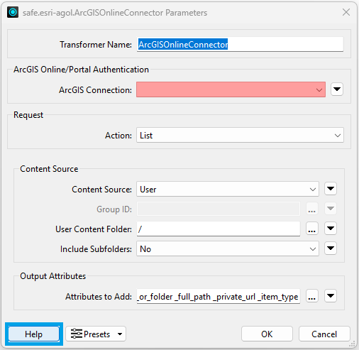

The Workbench help is context-sensitive and provides help for specific objects and settings while you use the application. From any object properties opened in your canvas, you can access the context-sensitive help in the Workbench app by pressing the F1 key or clicking the Help button on the object's dialog box.
  • For help with a format reader or writer, click the source or destination object on the canvas and press F1.
  • For help with a transformer, click the transformer object on the canvas and press F1.
  • For help with a particular setting, click the Help button found at the bottom left corner of the object's dialog box.
Help button on canvas object
Sample transformer with the Help button highlighted

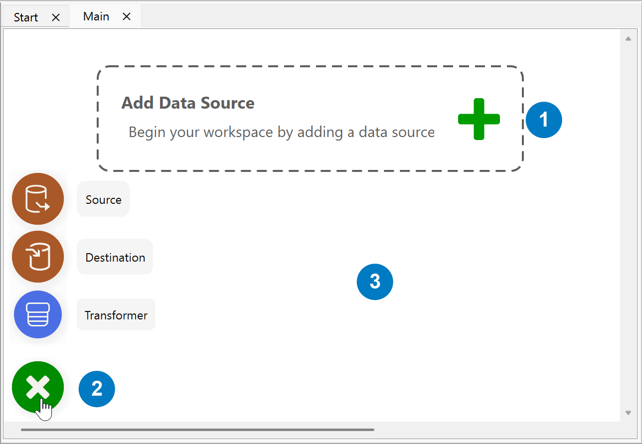

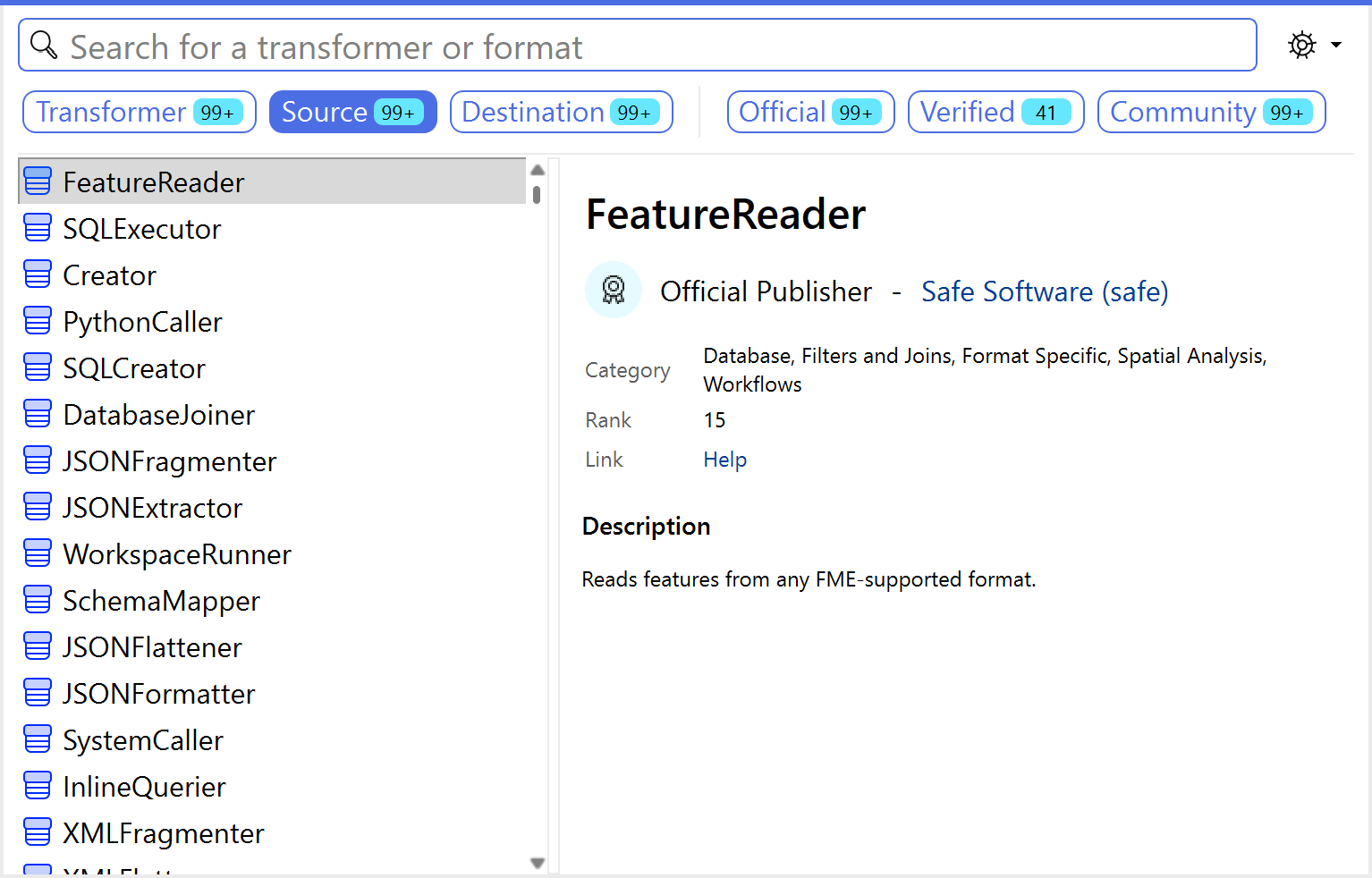

  • Use the Quick Add dialog to add datasets, transformers, and connectors to your canvas. The dialog has text search filter, category filters, and provides quick info to highlighted canvas object.
Workbench quick add gallery
This dialog appears in multiple ways—using any of the two Quick Add buttons on the canvas or by typing on your keyboard in the context of the canvas.
Workbench quick add triggers
  1. The Add Data Source box opens the Transformer Gallery dialog with the Source category selected.
  2. The Quick Add button on the lower left corner shows the Source, Destination and Transformer categories in the Transformer Gallery dialog.
  3. Click on the white space of the canvas and start typing to search the gallery by typing text. For example, type the letters "ute" will filter the gallery to show all transformers with "ute" in their name, such as AttributeCreator, AttributeRemover, etc.

Transformer Gallery
Transformer Gallery is an explorer window that enables you to browse for transformers by category or search for them by entering one or more keywords that describe a name or function. To add a transformer to your workspace, double-click or drag the transformer onto the canvas.
To open the Transformer Gallery window from the main menu, click View > Window Layout > Transformer Gallery.
