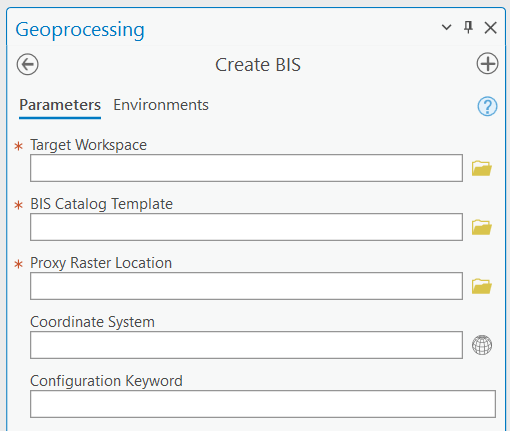

    Create BIS tool Parameters tab
  5. For the Target Workspace parameter, click Browse and browse to and choose the file or enterprise geodatabase where the BIS will be created.

  6. For the BIS Catalog Template parameter, browse to <ArcGIS Pro installation location>\ArcGIS\Pro\Resources\Bathymetry and double-click BISCatalog_schema_MGDB.geodatabase.

  9. For the Proxy Raster Location parameter, choose the directory where you want to store the proxy raster .tif files.

  10. Optionally, click Select coordinate system and specify a coordinate system for the BIS.
    If no coordinate system is specified, WGS84 is used by default.
  11. Optionally, under Geodatabase Settings, provide a value for the Configuration Keyword parameter.
