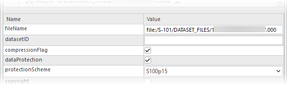

  5. Click the file element under dataDiscoveryMetadata to view its attributes in the editing section, and ensure that compressionFlag and dataProtection are checked.
    When a user permit is loaded, the compressionFlag and dataProtection parameters are automatically checked.
    compressionFlag and dataProtection parameters checked in the dataDiscoveryMetadata attributes

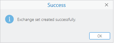

    Provided the export occurs without error, the Exchange set created successfully message appears.
    Success message
