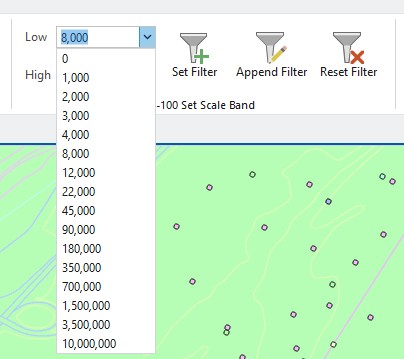

  5. On the Maritime S-100 tab, in the S-100 Set Scale Band group, click the Low drop-down arrow and choose a value.
    Tipp:
    You can also type a value in the Low combo box. The value must contain only numeric characters.
    S-100 Set Scale Band Low drop-down
    In the S-100 Set Scale Band group, when the low or high value is set above or below the other, the values are automatically adjusted to maintain a logical range. For example, if the high value is set to 2,000 and the low value is updated to 4,000, the high value is automatically adjusted to 8,000.
