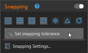

Snapping
Use the Snapping pane to set your snapping preferences. These controls are also available in the pop-up menu on the status bar at the bottom of the active map.
Snapping pane

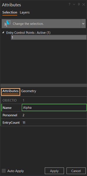

Attributes
The Attributes tool opens the Attributes pane, where you can edit feature attributes and related records, modify annotation properties, and manage file attachments.
Attributes pane

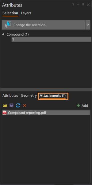

Attachments tab
The Attachments tab and toolbar appear in the Attributes pane when you select a feature with file attachments enabled.
Attachments tab in the Attributes pane

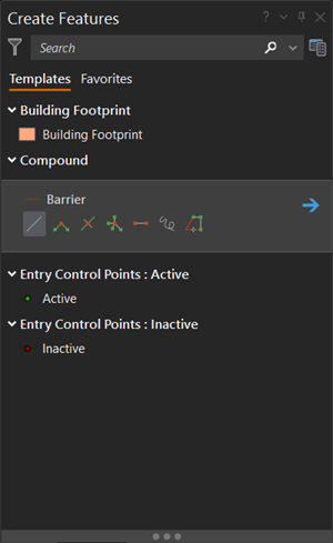

Create
The Create tool opens the Create Features pane, which contains the feature templates and related construction tools for layers in the active map.

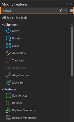

Modify
The Modify tool opens the Modify Features pane, which contains the full collection of editing tools that modify features. On the My Tools tab, you can create a customized collection of tools for quick access.

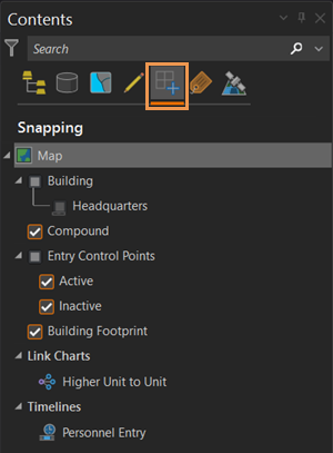

List By Snapping
Check the layer check boxes under Snapping on the List By Snapping tab to enable snapping for a layer.
Contents Snapping
