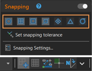

Configure snap agents
Snapping controls the accuracy of the pointer when you hover near a vertex, an endpoint, or other geometric element. Enable a combination of snap agents to help you work more efficiently and accurately. Turn snapping on and off to control when the snap agents are applied to the pointer.
Tip:
Press the Spacebar to temporarily turn snapping off while you create or modify features.
To turn on snapping or configure snap agents, complete the following steps:
  1. Click Snapping on the status bar to turn snapping on and off.
    Snapping
    Alternatively, on the ribbon, click the Edit tab, and in the Snapping group, click Snapping .
  2. To enable and disable the snap agents, hover over Snapping on the status bar.
    Snap agents
    Alternatively, on the ribbon, click the Edit tab, and in the Snapping group, click the Snapping drop-down menu .
