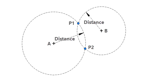

The following diagram illustrates how the tool locates and highlights where two distances intersect, shown as P1 and P2, measured from two known locations shown as A and B:
Diagram showing Distance Distance
The diagram shows intersections P1 and P2 measured from origin locations at A and B.
