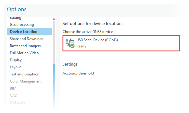

    1. On the View tab, in the Device Location group, click the Device Location Options dialog box launcher .
    2. In the Options dialog box, click the Device Location tab.
    3. Click the GNSS device arrow, choose the active GNSS device, and set the accuracy threshold.
    4. To change the accuracy threshold, type the value in the Accuracy threshold text box, and set the units.
    5. Click OK.
