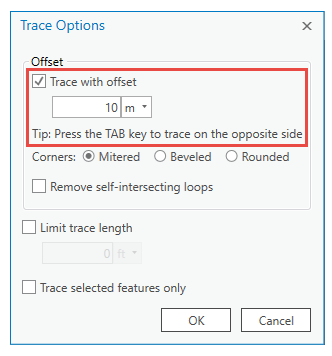

Trace with an offset
Use the Trace with an offset option to create segments at a specified offset. For example, you can click a water main feature template, set an offset of 7 meters, and trace along a parcel boundary to create water mains that run parallel to the parcel boundary at a constant offset.
  1. Click Trace .
  2. Right-click the map, and click Trace Options.
    The Trace Options dialog box appears.
  3. Check the Trace with an offset check box.
    Trace Options
  4. Click the Units drop-down arrow, set the format, and type the offset distance in the text box.
  5. Click OK.
    Your settings are saved and the dialog box closes.
  6. Trace the existing feature or features.
    Tip:
    Press the Tab key to toggle the offset to the opposite side of the feature.
  7. To finish the feature, right-click and click Finish or press the F2 key.
