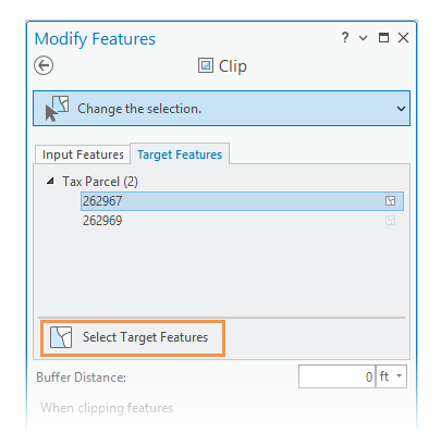

Clip the feature with another feature
The Clip tool allows you to clip a target feature with an overlapping feature representing a hole. To remove the area representing the hole, choose the Discard (Remainder) setting . The input feature is not deleted.
To cut a hole in a feature by clipping it with an overlapping feature, complete the following steps:
  1. Add your data and configure settings for editing.
    Confirm that the feature layer you are editing is editable, the coordinate system assigned to the active map is suitable for the type of edits you're performing, and snapping is configured to help you work efficiently and accurately.
    Note:
    Confirm that map topology is turned off. This allows you to move the input feature away from the target feature and show the hole.
  2. On the ribbon, click the Edit tab. In the Features group, click Modify .
    The Modify Features pane appears.
  3. Click the Clip tool .
    To find the tool, expand Divide, or type Clip in the Search text box.
  4. Uncheck the Clip all editable features check box.
    The Input Features and Target Features tabs appear in the pane.
  5. Click the Input Features tab and select the overlapping feature representing the hole using the following steps:
    1. Click Select one or more points, lines, or polygons in the pane, and select the feature.
      To filter the selected feature in the pane tree view, right-click the feature and click Only Select This .
      The Selection Chip icon appears near the pointer.
    2. Click the Selection Chip drop-down arrow and choose the nested feature representing the hole.
    Note:
    If the Selection Chip icon does not appear near the pointer, enable the selection chip application setting.
  6. Click the Target Features tab and select the feature to be clipped using the following steps:
    2. Click the Selection Chip drop-down arrow that appears near the pointer and choose the nested feature representing the hole.
    Tip:
    Click Select Target Features to automatically select all features crossing the input feature on all editable layers.
  7. Click the Buffer Distance box, and type a buffer distance of zero (0) if the input feature is a polygon feature.
    Type a buffer distance greater than zero (0) if the input feature is a line feature.
  8. Choose Discard (Remainder) .
  9. Click Clip.
    The clipped area defined by the input feature is removed from the target feature. The input feature is not deleted and is the current selection.
  10. Click the Move tool in the Modify Features pane and drag the input feature away from the hole.
    Alternatively, delete the input feature, or turn off visibility for the input feature layer.
