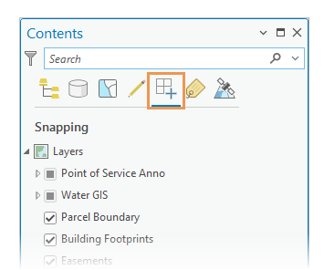

  1. On the ribbon, click the View tab. In the Windows group, click Contents .
  2. Click the List By Snapping tab in the Contents pane.
    List By Snapping
  3. To enable or disable snapping for one or more layers, choose from the following methods:
    Method
    Description
    Check a layer check box.
    Enable snapping for the selected layer.
    Uncheck a layer check box.
    Disable snapping for the layer.
    Press Ctrl+Shift and click a layer check box.
    Enable or disable snapping for all layers.
    Right-click a layer and click Make this the only snappable layer Point
    Enable snapping for the selected layer and disable snapping for all other layers.
