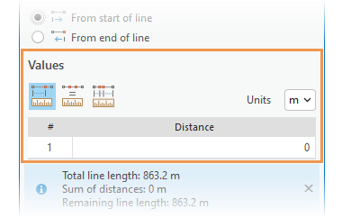

  7. In the Values section, click the Units drop-down arrow and choose a unit format.
    Divide Distance Values
  8. Click one of the following methods and enter the required values for distance and the number of repetitions:
