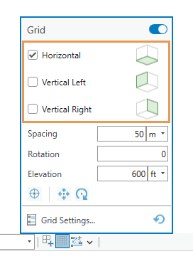

  4. Check the Horizontal check box and, optionally, the Vertical Left or Vertical Right check box to enable the vertical grid.
    3D grids
