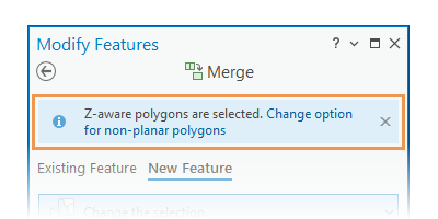

  • To merge overlapping z-aware polygons, allow nonplanar geometry to be created by this tool in the project and application Options dialog box.
    Tip:
    Click the link in the notification to open the Options dialog box.
    Link to Options dialog box

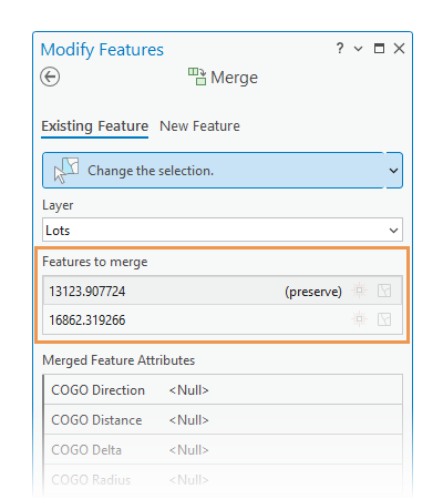

  4. Click the Existing Feature tab.
  5. Click the Select two or more features tool , and select the features you are merging.
    If features are currently selected, the selection tool displays Change the selection.
    Tip:
    For steps to change the field that uniquely names a feature in the Features to merge section, see Set the layer display field.
    The selected features appear in the Features to merge section, and their origin layers appear in the Layer drop-down list.
  6. Click the Layer drop-down arrow and choose the layer containing the features you are merging.
    If all selected features are on the same layer, only one layer is available.
    The selected features appear in the Features to merge section.
  7. Click the feature in the Features to merge section containing the attribute values you want to preserve.
    To flash a feature in the map, click Flash .
    To remove a feature from the selection, click Unselect .
    Merge Existing Feature
    The (preserve) label appears next to the preserved feature and the feature highlights in the map.
  8. Optionally, edit the attributes in the Merged Feature Attributes section.
  9. Click Merge.
    The selected features are merged into the feature with the (preserve) label.

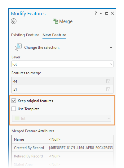

  7. Check or uncheck the Keep original features check box.
    Checked
    Keep the source features.
    Unchecked
    Delete the source features.
    Tip:
    To preserve the source features for historical reference and apply the attributes of an existing feature to the new feature, check the Keep original features check box, uncheck the Use Template check box, and click the feature in the Features to merge section.
    Merge New Feature
  8. Check or uncheck the Use Template check box.
    Checked
    Obtain the attribute values from an editing template. Click the drop-down arrow and choose a template. If the layer is different than the source layer, the new feature is created on the layer specified by the editing template.
    Unchecked
    Obtain the attribute values from a selected feature. Click the feature in the Features to merge section containing the attribute values you want to apply to the new feature.
    The attribute values appear in the Merged Feature Attributes section. You can edit the attributes before merging.
  9. Click Merge.
    The selected features are merged into a new feature with a new OBJECTID field value.
