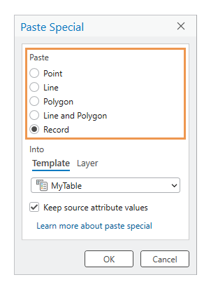

    The Paste Special dialog box appears.
  6. If the clipboard contains a mix of feature types or records from a table, choose the type you are pasting in the Paste section.
    Paste Special feature choices
  7. Click the Template or Layer tab.
    The selected tab determines how source attribute values on the clipboard are pasted and the available optional methods for transferring attributes.

  8. Click the drop-down arrow and choose an editing template or a layer.
  9. Check or uncheck the Keep source attribute values check box.
