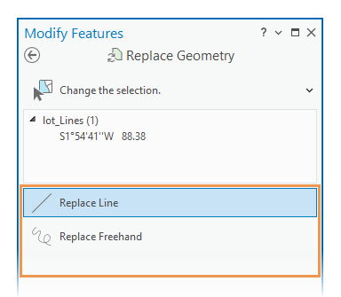

    The selected feature appears in the selection view and feature construction tools specific to its geometry type appear in the tool pane. Tools that create other geometry types are not shown.
  5. Click a construction tool in the tool pane and draw the new feature geometry.
    Replace Geometry
    Only the construction tools that create geometry for the selected feature appear in the tool pane.
