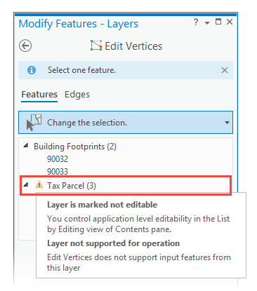

Selection warnings
If the active tool is unable to edit a selected feature, a warning appears in the selection tree view. Hover over the icon to view information about the cause and a possible solution.
Modify Features - Layers pane with Tax Parcel selected
