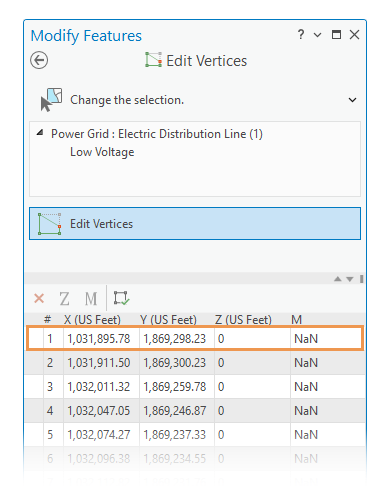

Hover over the vertex you want to set as the origin vertex.
When the pointer changes to the directional cursor
, right-click and click Set Origin Vertex
.The selected vertex changes to the origin vertex and appears in the top row in the geometry properties table for the selected polygon feature or part. The order of vertices is preserved and updates accordingly. If the selected feature is a multipart polygon, only the vertices for the selected part update.

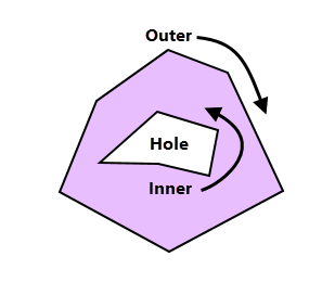

A polygon feature is defined by one or more closed boundaries (or parts) that are organized as one or more outer boundaries and zero or more inner boundaries. Each boundary consists of a contiguous set of line segments with the same vertex defining the start and end.
An outer boundary is oriented clockwise while an inner boundary is oriented counterclockwise. If a polygon has an inner boundary, the region created by the boundary displays as a hole. Similarly, if a hole contains a boundary, the region displays as an island.
Stepping through an outer boundary from the first vertex to the last vertex, the area to the right is referred to as the interior of a polygon and the area to the left is referred to as the exterior.
