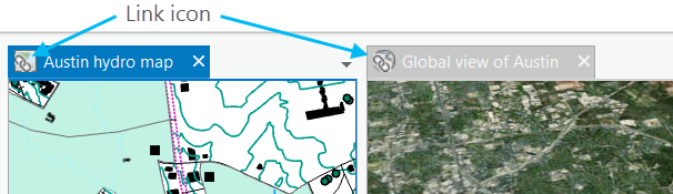

When you enable view linking, all views in your display will automatically link (according to your chosen link option) to the currently highlighted, or active, view. This includes any newly opened views to the project even after linking has already been turned on. The linked state is denoted by the chain symbol overlapping each views icon.
The view linking indicator icon overlaps the map view type as shown here with the chain symbol.
The 3D view is linked with the active map view as indicated by the chain link symbol.
