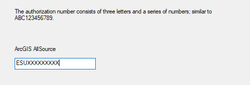

  9. On the Software Authorization Number page, provide your license number.
    ArcGIS AllSource authorization number in the Software Authorization Wizard
  10. Click Next to start the authorization process.
