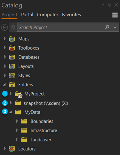

Folder connections in the Catalog pane
After connecting to a folder, such as MyData, you can browse to its subfolders and files.
Number
Description
A connection to the project home folder (created by default)
A connection to a folder on a network drive
A connection to a folder on a local drive
