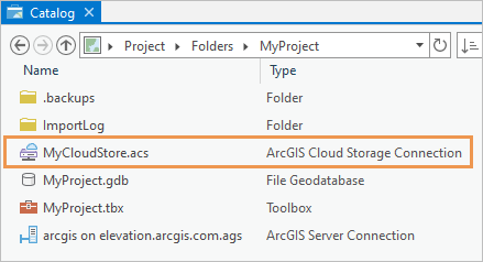

A cloud storage connection in a catalog view
By default, cloud storage connection files are saved to the project home folder.
