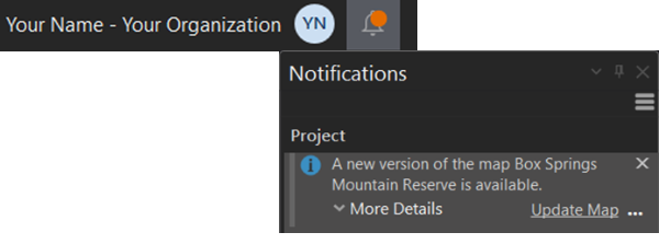

While working on a project, you may receive notifications about ArcGIS AllSource, the project, or items you are using in the project. When the notifications button in the upper right corner displays a grey dot, notifications are available.
Notifications button with pane

Act on a notification
Take action by clicking an operation associated with the notification.
  1. Click the notifications button to open the Notifications pane.
  2. Hover over a notification.
    Operations appear in the bottom corner of the notification.
  3. Click the primary operation. For example, when notified that a new version of the map is available, click Update Map.
  4. If additional operations are available, click the options button in the corner to list them, and click the appropriate operation.
