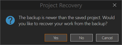

    A Project Recovery prompt informs you that the backup project was saved more recently than the original project.
    If the prompt does not appear, it means that the original project was saved more recently than the backup project. In this case, unsaved changes cannot be recovered.
  3. Choose how to proceed.
    • Yes—Open the backup project. Unsaved changes are recovered up to the time stamp of the backup project.
    • No—Open the original project. The project state reflects the last manual save. Unsaved changes are lost.
    • Cancel—Dismiss the prompt without opening the project.
