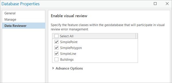

  7. To enable visual review, check the check box next to the listed feature classes for which you want to enable visual review.
    Database Properties dialog box with the Data Reviewer tab active and the Enable visual review settings
    Tip:
    To enable visual review for all of the listed feature classes, check the Select All check box.

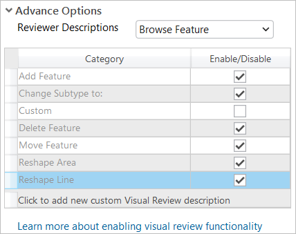

  8. Click the Visual Review Advanced Options drop-down arrow to enable more specific rule configurations for the Browse feature and Flag missing features tools.
    Enable visual review Advance Options drop-down menu
