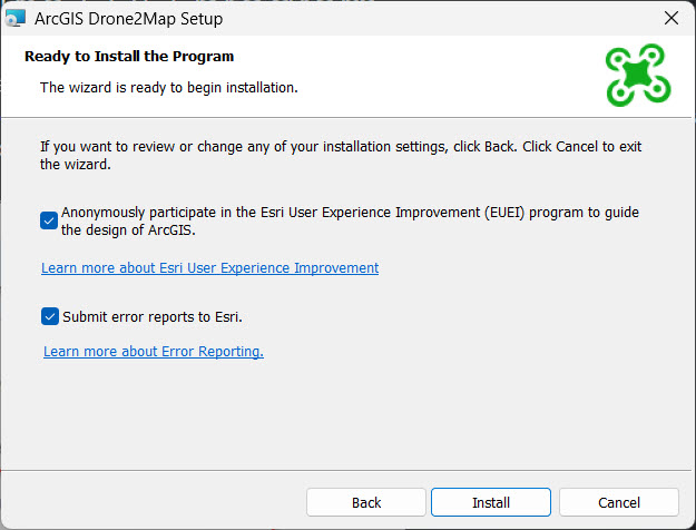

When you install Drone2Map, one of the preliminary steps prompts you to participate in the EUEI program. By default, the check box to participate is checked on. If you don't want to participate, uncheck the check box before proceeding.
EUEI Setup dialog
