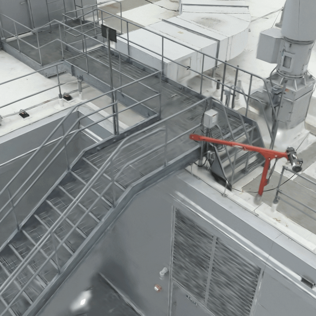

Gaussian splats products now offer faster processing times when working with large datasets. Small details on objects and areas with complex textures are better represented when using the High or Ultra point cloud density settings.
Gaussian Splats now offer finer detail on objects and textures.

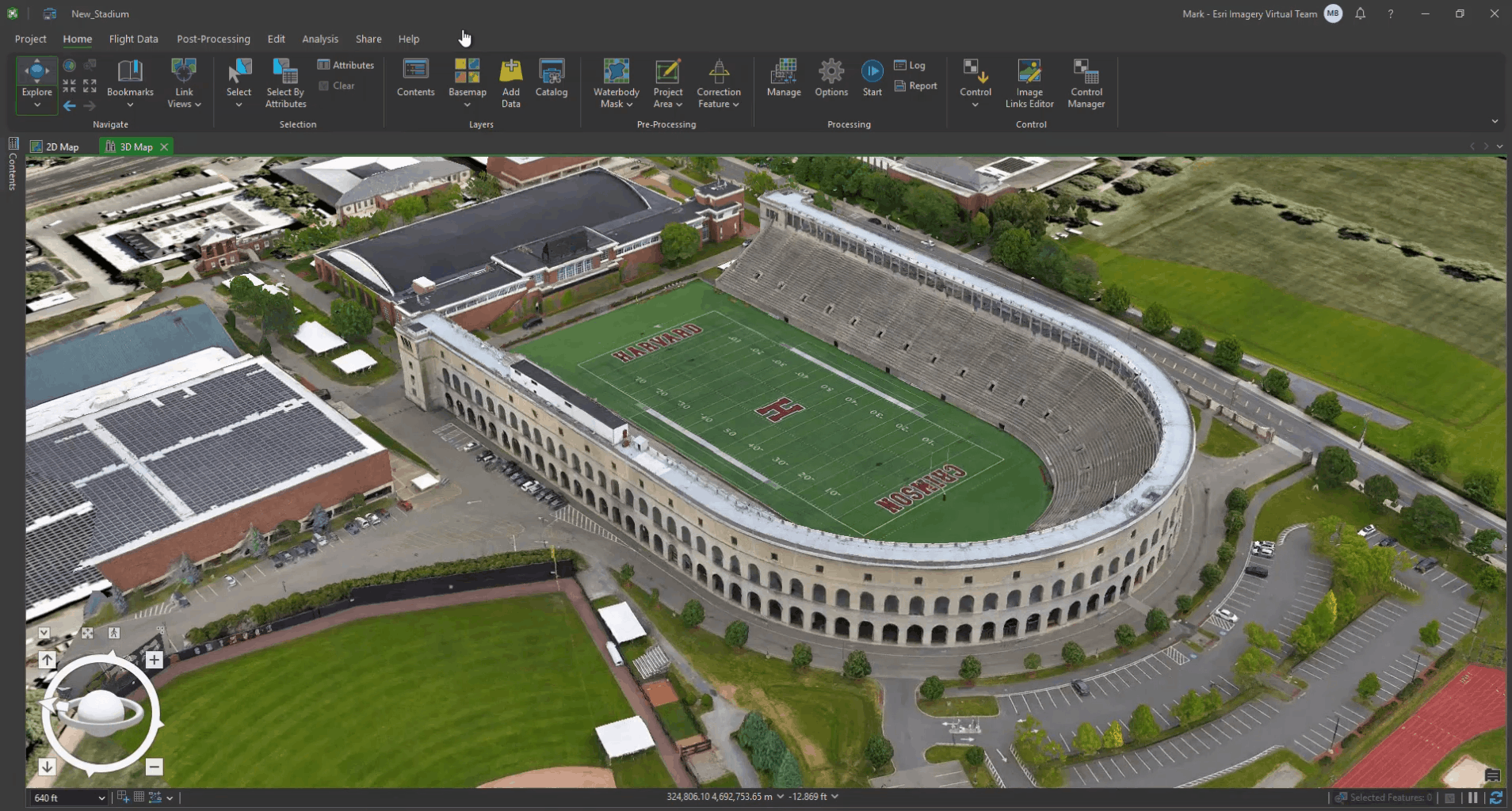

3D mensuration enhancements
The Measure Vertical tool is now available for use in 3D Maps. This tool allows you to measure an object’s height or vertical difference between two locations. It can be useful when performing inspections in 3D or visualizing the height differences of clustered features.
Drone2Map now offers the ability to measure vertically.

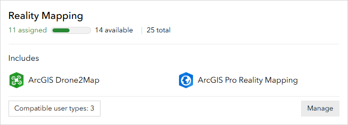

ArcGIS Drone2Map 2026.1 will move from multiple license levels (Standard and Advanced) to a single Reality Mapping license. This new license will become the way to access ArcGIS Drone2Map, and all its capabilities. As part of this transition, users with Standard licenses will have all Drone2Map Advanced capabilities unlocked under the new Reality Mapping license.
If you are assigned a Professional or Professional Plus user type, the 300 gigapixel limit for Drone2Map projects will no longer be present, allowing for processing of large datasets without having to be split into sub projects.
New Reality Mapping license
No projects, data, or workflows are impacted as a result of this change. Users can continue working as they do today, with access to more capabilities once the new license is assigned.
In addition to Drone2Map capabilities, the Reality Mapping license also includes access to ArcGIS Reality for ArcGIS Pro, an extension for ArcGIS Pro that allows users to perform reality mapping workflows using drone, aerial, and satellite imagery. These ArcGIS Reality for ArcGIS Pro capabilities are available only to users with Professional or Professional Plus User Types.

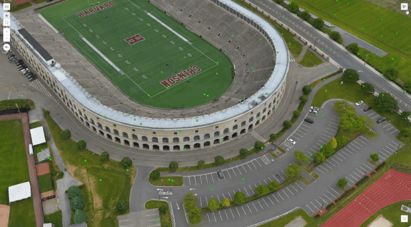

Ground control improvements
Auto link detection performance has been improved by more than 30% while maintaining a high level of accuracy. The largest time reduction benefits will be seen on large projects with a high number of ground control points being detected.

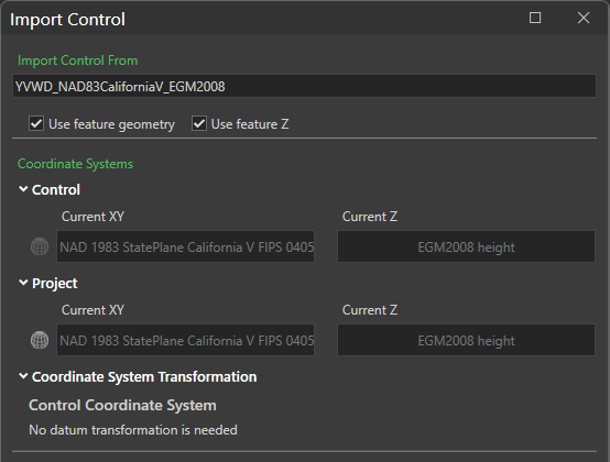

The import process for ground control points that use a geographic coordinate system has been updated to allow the specification of any project coordinate system rather than automatically default to the nearest UTM zone. This helps save time by eliminating the need for any reprojection of products. If a transformation is needed, this can now also be applied within the same section.
New coordinate system settings for import control

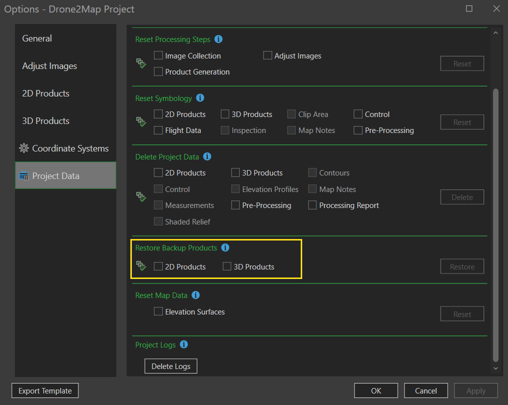

The ability to restore backed up products has been added to projects. These options allow you to restore output products to their original state. If more than one backup exists, the original product for the project will be restored. For workflows making use of re-processing, these options help provide stability by eliminating the need to recreate projects.
New product backup options

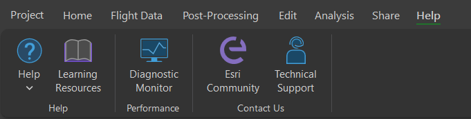

Drone2Map 2026.1 introduces a new help tab allowing you easy access to documentation, performance tools and product support.
New Help tab in Drone2Map

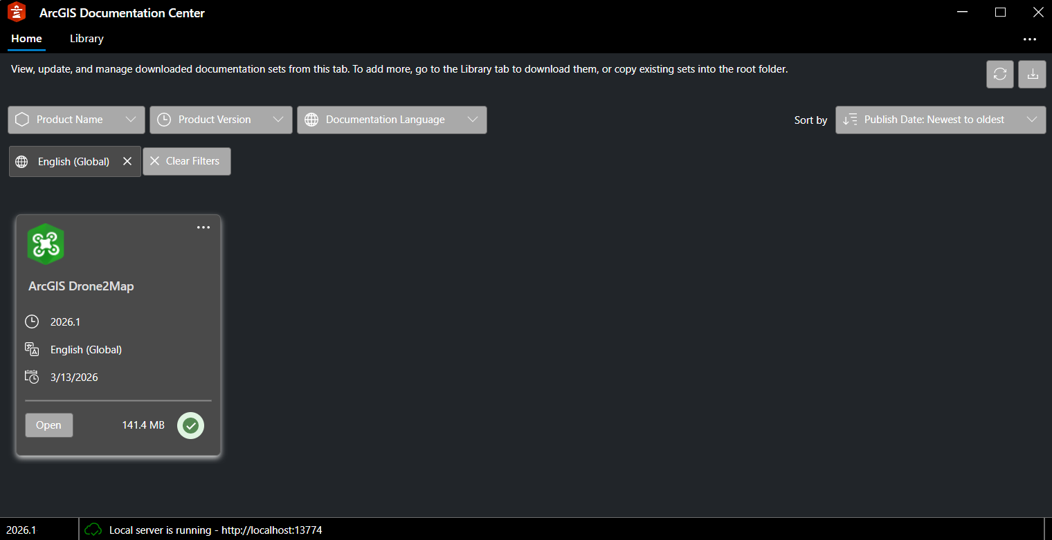

Offline documentation capabilities have been upgraded through the introduction of a new ArcGIS Documentation Center application. This application allows you to download and reference the latest help documentation offline, but still view it in the same user interface as the web. Older versions of help documentation and different supported languages can also be downloaded into ArcGIS Documentation Center so they can be easily accessed in one place.
ArcGIS Documentation Center application with Drone2Map documentation downloaded

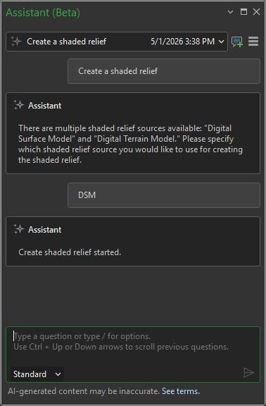

AI Assistant
A new AI Assistant is being tested for Drone2Map within an Early Adopter Community beta program. The assistant allows you to quickly query documentation and automate various workflows within a project. To learn more about the beta see: ArcGIS Drone2Map AI Assistant Beta
New AI Assistant beta pane for Drone2Map
