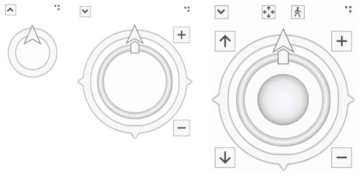

On-screen navigator
The on-screen navigator exposes many camera navigation commands with a single control in the lower corner of a view. The explicit camera controls are useful for navigating through challenging GIS content, particularly 3D scenes that are underground and in buildings, or that contain lidar. The control is suitable for touch screen interaction. It can rotate around a target point, making it well suited for feature inspection and 3D editing. As a passive element in the view, the navigator always indicates north. The images below show the navigator in a minimized state for heading only, compared to the full control state for 2D and 3D views.
Navigator heading only, Full control navigator in 2D and Full control navigator in 3D
To display or hide the navigator in a view, on the View tab, in the Navigation group, click the Navigator button. To resize the navigator, drag the resize handle at the top of the control.
In its smaller display mode for heading, the navigator displays a north indicator. You can pan around a map or scene by clicking and dragging the outer ring. A partially transparent arrow indicates the pan direction and velocity. Click the north arrow to reset the camera to face north again.
In its maximized display mode, the navigator exposes additional camera navigation capabilities. In 2D, this includes rotating the view; zooming in and out; and turning to face east, west, or south. In 3D, this includes rotating the view direction (only), pivoting around the target point in all three axes, zooming in and out on the target point, moving the camera up and down, and looking around from the current camera position.
By default, the navigator is hidden in 2D views and shown in its heading state in 3D views. Click the Project tab, click the Settings tab, and on the Settings dialog box, under the Application heading, click the Navigation tab, and expand the On Screen Navigator heading to configure these options.

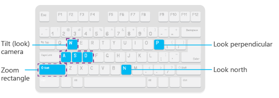

One of the primary tools for interacting with the view is the Explore tool . The shortcut keys described below are assigned to work specifically in conjunction with the Explore tool only. Press the key to perform the action and release it when you're finished. Shortcuts such as P and N are a one-time press to automatically adjust the view. This is different from rotating the camera and zooming, which are actions that require you to press the keys while using the Explore tool to update the view.
The following image shows some of the shortcut keys:
Shortcut keys to use with the Explore tool
The following table lists the shortcut keys:
Keyboard shortcut
Action
Description
P
In a 3D scene, look straight down (perpendicular).
Press the key once and the view automatically shifts so it is looking straight down on top of the data.
N
Adjust the view to point north.
If you rotated the view, this resets the orientation to face north.
Shift+drag
Zoom in by drawing a rectangle.
Shift+click
Center and zoom in to the pointer location.
Ctrl+click
Center the view to look at the pointer location.
In 2D, this centers the view. In 3D, the camera turns to center and looks at the location.
W
In a 3D scene, tilt the camera up.
This is like tilting the camera from a fixed point.
S
In a 3D scene, tilt the camera down.
A
Rotate the camera counterclockwise.
This behavior is a camera tilt or rotation.
D
Rotate the camera clockwise.
Keyboard shortcuts for navigating the map with the Explore tool activated

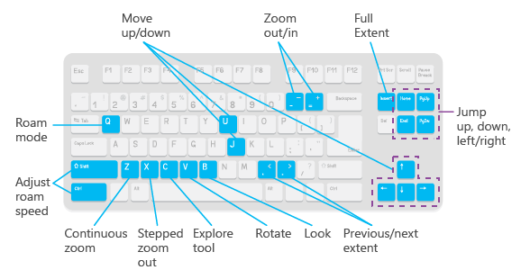

The keyboard shortcuts described below are always available, regardless of the active tool. Whether you are navigating and want to return to a previous extent or are performing a selection, edit, or measure task and need to modify the perspective, use these shortcuts for fingertip access to navigation.
Keyboard shortcuts that are always available regardless of the active tool

Insert
Zoom to full extent.
Yes
Yes
Zoom to the full extent of the layers in the map or scene.
Hyphen (-)
Zoom out.
Alternatively, use the minus sign (-) on the numeric keypad.
Yes
Yes
Incrementally zoom out.
Equal sign (=)
Zoom in.
Alternatively, use the plus sign (+) on the numeric keypad.
Yes
Yes
Incrementally zoom in.
Ctrl+Alt+S
Activate the Select tool.
Yes
Yes
Activates the Select tool at the mouse pointer.
Ctrl+Alt+C
Activate the Explore tool.
Yes
Yes
Activates the Explore tool at the mouse pointer.
C
Override the active tool with the Explore tool.
Yes
Yes
Press and hold C to use the Explore tool when you are in the middle of another task using another tool.
  • Left button drag—Pan
  • Left button click—Pop-up
  • Wheel button scroll—Zoom
  • Wheel button click and drag—Tilt and rotate in 3D
  • Right button drag—Continuous zoom in and out
Press C+Shift or C+Ctrl while using another tool to center and zoom in, or center, respectively.
Alt + click one or more layers in the Contents pane
Zoom to the layer's extent.
Yes
Yes
Zoom to the extent of the data for a layer or set of selected layers from the Contents pane.
Z
Zoom continuously.
Yes
Yes
Press the Z key while dragging the left mouse button to change the active tool to continuous zoom in or zoom out mode.
X+click
Zoom out incrementally.
Yes
Yes
Click to zoom out incrementally away from the data.
V+drag
Rotate.
Yes
Yes
Rotate around a pivot point where you click on the view.
V + arrow keys
Rotate around the center of the view.
Yes
Yes
Press V with the Up arrow, Down arrow, Left arrow, or Right arrow keys to rotate around the center of the view.
O
Orient the view north.
Yes
Yes
In a 3D scene, in addition to orienting north, the view will also pivot to look straight down.
B+drag
Look around a 3D scene.
No
Yes
In a 3D scene, click and drag while pressing B to turn the camera and look around from the place where you click.
B + arrow keys
Look around from the current position.
Yes
Yes
In a 2D scene, press B while pressing the Up arrow , Down arrow, Left arrow, or Right arrow keys to move the view left, right, up, or down. In a 3D scene, press B while pressing the Up arrow, Down arrow, Left arrow, or Right arrow keys to manipulate the camera to look around the current location.
Comma
Go back to the previous extent.
Yes
Yes
Go back to the previous extent, if it exists.
Period
Go forward to the next extent.
Yes
Yes
Go forward to the next extent, if it exists.
Q
Roam.
Yes
Yes
Press Q while moving the pointer.
In 2D, the view is panned in the direction indicated. The farther the pointer is from the center of the view, the faster panning occurs.
In 3D, the camera's attitude and altitude are maintained as the view is panned in the direction indicated by the pointer away from the center of the view.
Q+Shift
Decrease the roam speed.
Yes
Yes
While pressing Q to roam, press Shift at the same time to slow down the roam speed.
Q+Ctrl
Increase the roam speed.
Yes
Yes
While pressing Q to roam, press Ctrl at the same time to speed up the roam speed.
Arrow keys
Move the view left, right, up, or down.
Yes
Yes
Use the arrow keys to move the camera up, down, left, or right. In 2D, this is like panning the view in increments.
You can repeatedly press the arrow key you need for fine-tuned panning adjustments, or press and hold the key to keep moving in one particular direction.
U
Move up, higher from the view.
Yes
Yes
In 2D, this is the same as continuous zoom out.
In 3D, press U to lift the camera up vertically.
J
Move down, closer to the view.
Yes
Yes
In 2D, this is the same as continuous zoom in.
In 3D, press J to move the camera down vertically.
Page Up
Jump one screen size up.
Yes
Yes
In 2D, pan jumps forward one screen width.
In 3D, the camera jumps forward one screen width while maintaining camera angle and altitude.
Page Down
Jump one screen size down.
Yes
Yes
In 2D, pan jumps one screen down.
In 3D, the camera jumps down one screen width while maintaining camera angle and altitude.
Home
Jump one screen size to the left.
Yes
Yes
The view jumps to the left one screen size.
In 3D, the camera jumps left one screen width while maintaining camera angle and altitude.
End
Jump one screen size to the right.
Yes
Yes
The view jumps to the right one screen size.
In 3D, the camera jumps right one screen width while maintaining camera angle and altitude.
Esc
Cancel map drawing.
Yes
Yes
F5
Refresh the active view.
Yes
Yes
Ctrl+F5
Clear the cache and refresh the active view.
Yes
Yes
