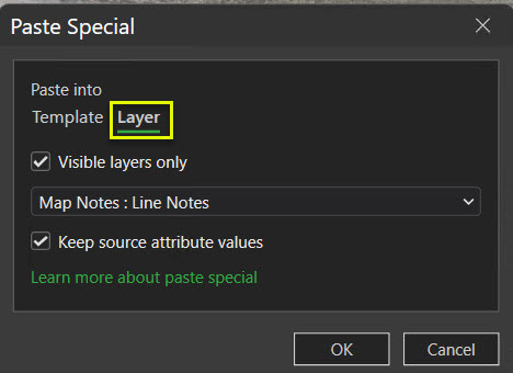

Paste to a specified layer
To specify a layer, click the drop-down arrow and choose a layer.
  1. At the top of the map, click the tab to make the map current.
  2. If the features are not copied to the clipboard, do the following:
    1. On the Edit tab, in the Selection group, click Select and select the features.
    2. On the Edit tab, in the Clipboard group, click Copy or press Ctrl+C.
  3. On the Edit tab, in the Clipboard group, click Paste Special or press Ctrl+Alt+V.
  4. If the Clipboard contains more than one geometry type, choose the feature type you want to paste.
    Note:
    Choosing Line and Polygon converts one of the feature types to conform to the destination layer.
  5. Click Template or Layer:
    Paste Special Layer
    Template
    Specifies the destination layer and attribute values defined by a feature template. If field mapping source and destination layers match the feature template destination layer, the attribute values copied to the feature conform to current field mapping settings.
    Layer
    Specifies the destination layer only.
  6. Click the layer drop-down arrow and choose a layer.
  7. Check or clear Keep source attribute values.
    Checked
    Copy the feature attribute values from the clipboard to matching fields on the destination layer.
    Unchecked
    Overwrite the feature attribute values with the geodatabase default values for the destination layer.
    Note:
    In this release of ArcGIS Drone2Map, this setting is disabled when pasting annotation features.
  8. Click OK to paste the features to the map.
    By default, the features are copied to the same location at which they were copied.
    • The Move tool will automatically activate. Use the repositioning tools to move, rotate, or scale the features.
    Reposition toolbar
  9. Click Finish or press the F2 key.

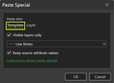

Paste attributes using field mapping
Specify the layer with a feature template to copy attribute values from the destination layer to the pasted features using the current field mapping settings. If the source and destination layers don’t match, the source geodatabase default values are copied to the new features.
    1. On the Edit tab, in the Selection group, click the Select button and select the features.
    2. On the Edit tab, in the Clipboard group, click the Copy button or press Ctrl+C.
    Note:
  5. Click Template.
    Paste Special, Template
  6. Click the template drop-down arrow and choose a template.
  7. Check Keep source attribute values.
    • If the Move tool is automatically active, use the repositioning tools to move, rotate, or scale the features.
    Reposition toolbar
