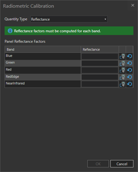

If the Quantity Type is set to Reflectance, a table appears listing the bands, along with a dialog box for computing the reflectance factor for each band.
Reflectance Factor table
  1. Click the Calculate button to open the Calculate panel reflectance factor window.

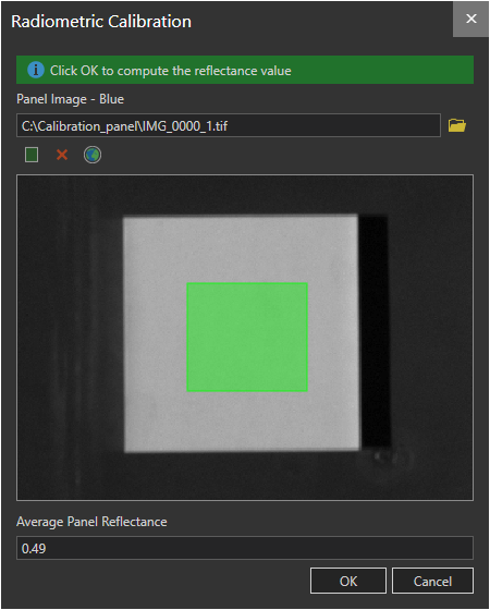

  2. Click the browse button and select the image of your surface reflectance panel.
  3. Click the Sketch area for calibration button and draw a new polygon within the calibration area of the panel.
    Panel sampling area
  4. Enter the reflectance ratio value provided in the Average Panel Reflectance text box, and click OK. Repeat this step for the remaining bands.
  5. Click OK to save the calibration settings.
