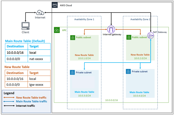

The Esri arcgis-vpc-dmz.template.json Amazon Web Services (AWS) CloudFormation template is part of an advanced workflow for configuring a highly available ArcGIS Enterprise deployment in private subnets. Private subnets are not directly accessible from the internet. This is referred to as a DMZ network architecture and can provide greater security. It requires knowledge of networking concepts and design and is only intended for highly available ArcGIS Enterprise deployments.
This template can create the following architecture in Amazon Web Services:
License:
Certain icons in the diagram are used with permission from Amazon Web Services.
