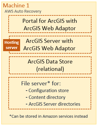

ArcGIS components
The configuration for this base ArcGIS Enterprise deployment is shown in the following diagram:
Single-machine ArcGIS Enterprise deployment on AWS created with Cloud Builder
