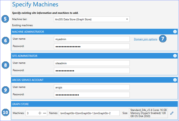

    In the following example, a three-machine graph store cluster is added.
    Steps 5 through 10, adding a graph store cluster to the deployment
