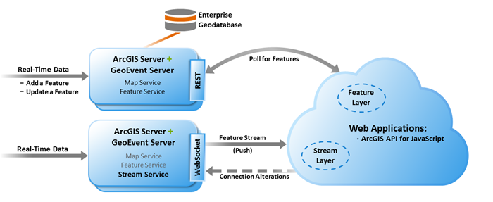

The illustration below compares how feature data has traditionally been received, processed, and consumed with how real-time data is received and broadcast using stream services.
Traditional feature data workflow versus real-time data received and broadcast with stream services
Notice in the upper portion of the illustration how, prior to stream services, real-time data had to first be in a feature class, which required an enterprise geodatabase. To display the data, client applications had to periodically poll the feature service to obtain new and updated features.
The lower portion of the illustration shows how stream services allow real-time data to be received and immediately pushed to clients via a WebSocket.
