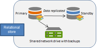

The relational store is always deployed in primary-standby mode. The first machine on which you install ArcGIS Data Store and create a relational store is the primary relational store machine. You can install and configure one other relational store with the same GIS Server site, making this second relational store machine the standby machine. Hosted feature layer data is replicated from the primary to the standby machine.
Data is replicated from the primary to the standby machine.

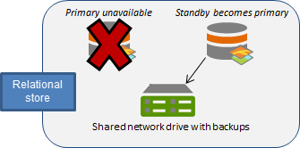

If the primary machine becomes unavailable (for example, if it crashes, loses power, or loses network connectivity), the standby machine is promoted to primary. You will only be without your hosted feature layer data for the period of time it takes for the standby machine to become the primary—this can take up to a few minutes. Once the standby becomes the primary relational store machine, it sends its backup files to the same location as the former primary machine.
Standby machine becomes primary when primary is inaccessible.
If you can correct the problem with the former primary machine—for example, if the machine was unplugged and you plugged it back in, or the machine temporarily lost network connectivity but network connectivity was later restored—the former primary becomes the standby machine for the relational store.
If you cannot correct the problem—for example, the machine crashes and cannot be recovered—use the removemachine utility to unregister the failed machine. Configure a new relational store machine to act as the standby machine.

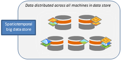

The spatiotemporal big data store is always deployed in cluster mode. You can install ArcGIS Data Store on several machines, create spatiotemporal big data stores on each, and register each one with the same hosting GIS Server site.
Data in the spatiotemporal big data store is duplicated on at least two spatiotemporal big data store machines registered to the same hosting server.
Spatiotemporal big data store containing five machines

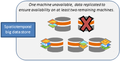

If any one machine fails, data still exists on at least one other machine. The data store replicates the data to another machine that is still functional.
One machine fails; data moved to remaining machines.
If the machine comes back online, it rejoins the cluster and data is rebalanced.

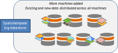

If the failed machine cannot be recovered, you can install ArcGIS Data Store on more machines and create spatiotemporal big data stores that are registered with the same hosting GIS Server site. In this example, three machines are added: one to replace the one that failed, and two more to accommodate increased numbers of hosted spatiotemporal feature layers. Data is rebalanced across all seven machines. Data for newly published spatiotemporal feature layers is also distributed.
Add machines to spatiotemporal big data store and data redistributes

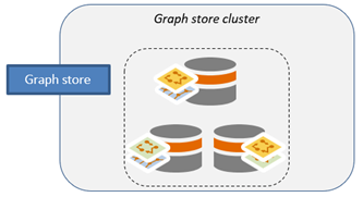

Starting with ArcGIS Data Store 11.5, the graph store can contain one machine (single instance) or three machines (cluster). If you require a highly available graph store, configure a graph store that contains three machines.
By default, when you install ArcGIS Data Store and create a graph store, it is created in single instance mode, but you can deploy in cluster mode instead. When you deploy in cluster mode, you must install and configure two other graph store machines with the same hosting GIS Server site. The graph store is not functional until it contains three machines.
When you deploy in cluster mode, hosted knowledge graphs will be duplicated on two of the three machines for high availability. The hosting server also queries all three machines, which improves query performance.
Data is distributed across the three machines in the graph store cluster.
