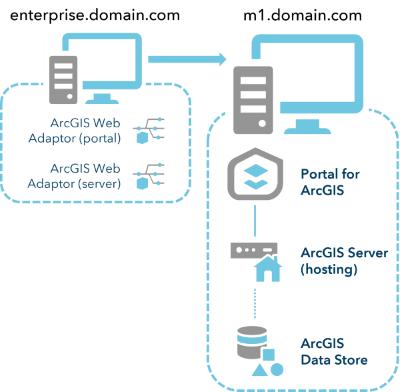

Base ArcGIS Enterprise deployment on one machine
Members access ArcGIS Enterprise in the following ways:
Organization members access as follows:
  • Content and items: https://enterprise.example.com/portal
  • Service endpoints: https://enterprise.example.com/server/rest
Organization administrators and publishers access as follows:
  • ArcGIS Server Manager: https://enterprise.example.com:6443/arcgis/manager
  • ArcGIS Portal Administrator Directory: https://enterprise.example.com:7443/arcgis/portaladmin
  • ArcGIS Portal Directory: https://enterprise.example.com:7443/arcgis/sharing/rest
To migrate this type of environment, complete the following steps:

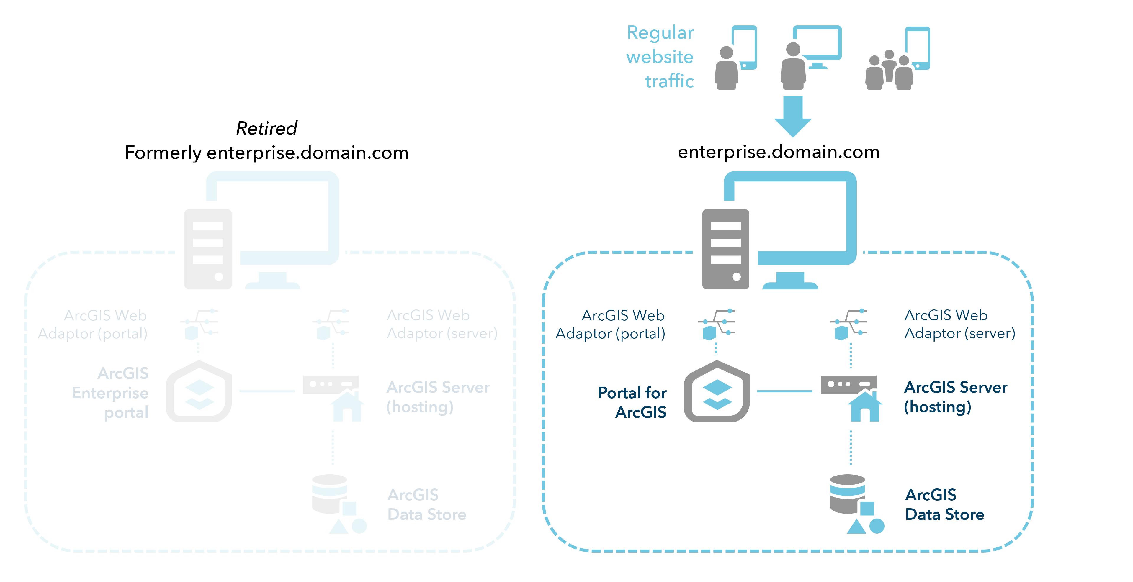

  9. Once the environment has been validated and you're ready to switch over, update the DNS to resolve enterprise.example.com to the new machine.
    All requests to enterprise.example.com will now resolve to the new machine, including all content from the old environment.
  10. Remove the 10.0.0.2 enterprise.example.com entry from the \etc\hosts file on the new machine and on any other machine to which you added it.
    Migrated machines after DNS resolution

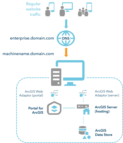

Migrate when ArcGIS Enterprise is accessed through an alias

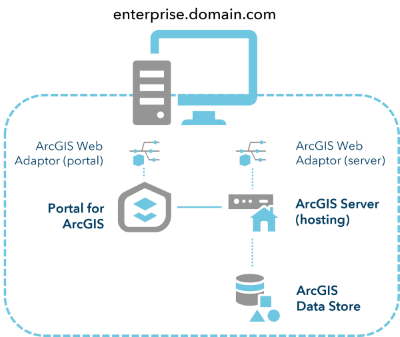

In this scenario, ArcGIS Enterprise is installed on a machine named machinename.domain.local and is running on a Windows Server 2016 operating system. Your DNS stores a CNAME, or alias, for the machine as enterprise.example.com.
  • ArcGIS Server Manager: https://machinename.domain.local:6443/arcgis/manager
  • ArcGIS Portal Administrator Directory: https://machinename.example.com:7443/arcgis/portaladmin
  • ArcGIS Portal Directory: https://machinename.example.com:7443/sharing/rest

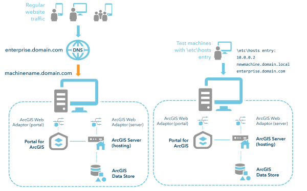

To migrate to this type of environment, complete the following steps:
  1. Acquire your new machine.
    This can be a virtual machine or physical machine.
    In this example, the machine's host name is newmachine.domain.local, its IP 10.0.0.2, and it's running Windows Server 2022.
  2. On the new machine, update the \etc\hosts file to resolve the IP address of the new machine to newmachine.domain.local as well as enterprise.example.com:
    10.0.0.2 newmachine.domain.local enterprise.example.com
    The \etc\hosts file must be updated before you install any software on the new machine.
    Listing the local host name into the \etc\hosts file first ensures that the software will store the name in configuration files, rather than the DNS alias. Adding the DNS alias ensures the deployment can be configured with the DNS alias without impacting production.
  3. Repeat step 2 on any other machine you will use to test and validate the new system.
    Note:
    This does not include the existing production machine.

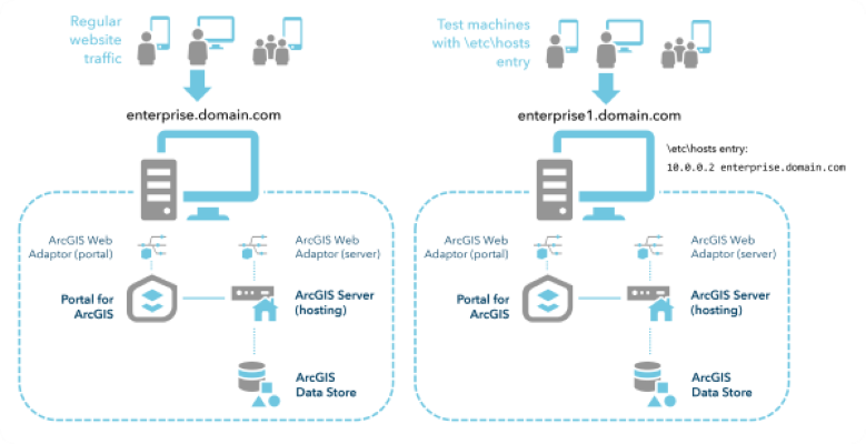

  4. Install and configure ArcGIS Enterprise components. Use the DNS alias when registering the Web Adaptor.
    Once the environment is configured, you can only reach the new environment through the enterprise.example.com host name from the machine itself or from any other machine that you've added the entry to. Any machines without the entry will resolve enterprise.example.com to your original production environment through DNS.
    Two machines during migration

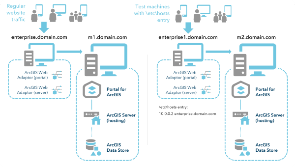

Migrate a multimachine deployment
If you have a distributed environment, you must modify the \etc\hosts file to ensure that the component acting as the front end for your deployment (its instances of ArcGIS Web Adaptor or reverse proxy) is resolving to the original name.
In this scenario, ArcGIS Enterprise components are distributed across two machines, both running a Windows 2016 operating system:
  • Two instances of ArcGIS Web Adaptor are installed on a machine named enterprise.example.com.
  • Portal for ArcGIS, ArcGIS Server, and ArcGIS Data Store are installed on a machine named m1.example.com.
The objective for this scenario is to migrate to a newer operating system, for example: Windows Sever 2022.
Base ArcGIS Enterprise deployment on two machines
  • ArcGIS Server Manager: https://m1.domain.local:6443/arcgis/manager
  • ArcGIS Portal Administrator Directory: https://m1.example.com:7443/arcgis/portaladmin
  • ArcGIS Portal Directory: https://m1.example.com:7443/arcgis/sharing/rest
To migrate an environment with this scenario, complete the following steps:
  1. Acquire two new machines, one to host instances of ArcGIS Web Adaptor and the other to run the rest of the components.
    The only IP address that matters in this case is the Web Adaptor machine, because the only settings that must match between deployments are https://enterprise.example.com/portal and https://enterprise.example.com/server. The IP address of the new Web Adaptor machine in this example is 10.0.0.2.
  2. On each new machine, update the \etc\hosts file to resolve the IP address of the Web Adaptor machine to enterprise.example.com:
  3. Install the two ArcGIS Web Adaptor instances on enterprise1.example.com.
  4. Install Portal for ArcGIS, ArcGIS Server, and ArcGIS Data Store on m2.example.com.
  5. Create the portal and server sites.
  6. Register the Data Store to the server site.
  7. Configure the instances of ArcGIS Web Adaptor on enterprise1.example.com by reaching the configuration page through https://enterprise.example.com/portal/webadaptor and https://enterprise/example.com/server/webadaptor.
    The requests will be resolved to the new Web Adaptor machine (which is actually enterprise1.example.com) through the \etc\hosts file.
    Distributed deployment during migration
  8. Federate your server site with the portal, and ensure that you use https://enterprise.example.com/server as the services URL.
    The admin URL can be either https://enterprise.example.com/server or https://m2.esri.com:6443/arcgis.
  9. Enable read-only mode in your existing deployment.
  10. Create a backup using the WebGISDR tool.
    It is important to consider timing when creating a backup. Once you create a backup using the WebGISDR tool, only the content present in the deployment will be moved over. If you were unable to enable read-only mode during step 1, this is especially important to consider. It's recommended that you run a backup during a period of downtime to prevent the loss of any new content.
  11. Restore the backup on the new machine with the WebGISDR tool.
    This will create a replica of the existing deployment on the new machine.
  12. Validate that users, content, groups, and services are accessible on the new machine, using any machine on which you have added the \etc\hosts entry.
    Only machines with the 10.0.0.2 enterprise.example.com entry in the hosts file will resolve enterprise.example.com to the new machine. Otherwise, those requests will go to the primary machine.

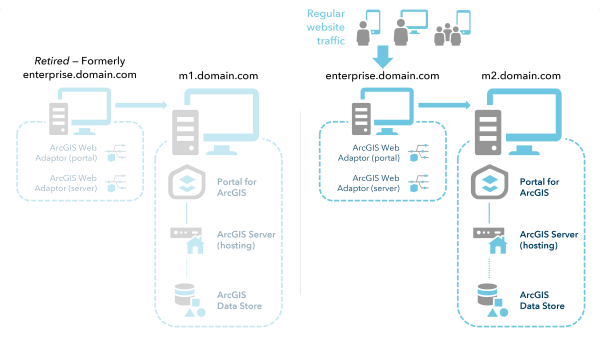

  13. Once the environment has been validated and you're ready to switch over, update your DNS to resolve enterprise.example.com to the new machine hosting the Web Adaptor and remove the \etc\hosts entry on that machine as well as on m2.example.com.
    All requests to enterprise.example.com will now resolve to the new machine, which will direct traffic to m2.example.com. There, you will be able to work with all the content from your old environment on your new machines.
    Distributed deployment after migration
