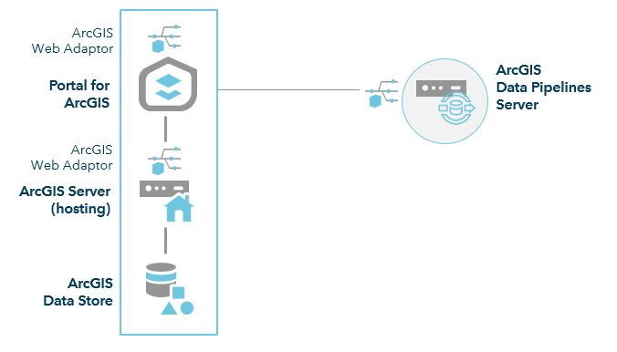

ArcGIS Data Pipelines Server
ArcGIS Data Pipelines Server is a no-code, visual data engineering capability that makes it easy to prepare and integrate data for mapping and analysis workflows.
To accommodate many data pipeline authors, or to provide each author with more resources for running data pipelines, you can join additional machines to an ArcGIS Data Pipelines Server site.
- Learn more about ArcGIS Data Pipelines Server system requirements.

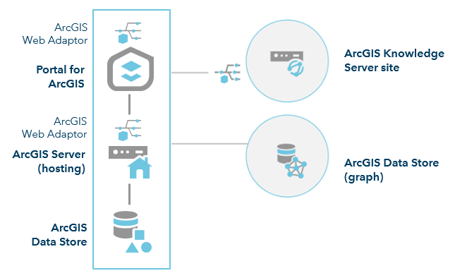

ArcGIS Knowledge Server
The ArcGIS Knowledge Server role enables ArcGIS Enterprise to model relationships between entities using knowledge graph layers.
To federate an ArcGIS Knowledge Server site to your base ArcGIS Enterprise deployment, you must also add an ArcGIS Data Store configured as a graph data store that is installed on its own machine.
Depending on the complexity and number of analyses you will run on the knowledge graph layer, you may need to add machines to the ArcGIS Knowledge Server site to accelerate your analysis. The diagram below illustrates this deployment pattern and includes a two-machine ArcGIS Knowledge Server site.
- Learn how to configure ArcGIS Knowledge.

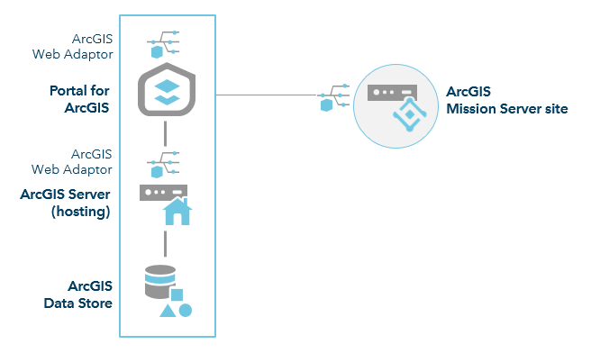

ArcGIS Mission Server
ArcGIS Mission Server provides the processing to facilitate communication between real-time updates in the field and the command center to streamline mission management and inform decision-making.
See an Introduction to ArcGIS Mission Server for details.

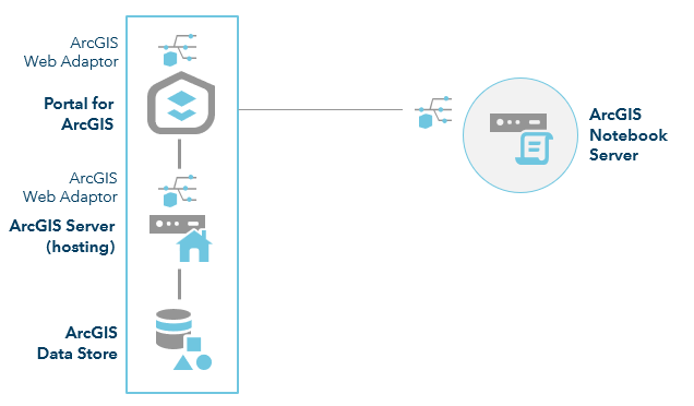

ArcGIS Notebook Server
ArcGIS Notebook Server is a complete data science platform integrated with ArcGIS Enterprise.
ArcGIS Notebook Server enables your ArcGIS Enterprise deployment to host and run ArcGIS Notebooks. Using the Python programming language, you can perform spatial analysis, craft data science and machine learning workflows, manage GIS data and content, and automate ArcGIS Enterprise administrative tasks.
ArcGIS Notebook Server sites are configured and federated with an ArcGIS Enterprise deployment. An instance of ArcGIS Web Adaptor is deployed and configured with each ArcGIS Notebook Server site.
ArcGIS Notebook Server uses containers—virtualized operating systems—to provide each notebook author with their own isolated working environment and computing resources within the machine. To allocate and maintain these containers, ArcGIS Notebook Server works with Docker container software. For ArcGIS Notebook Server to function, Docker Engine must be installed and configured on the same machine. The complete steps to set up Docker Engine are contained in the ArcGIS Notebook Server installation guide.
To accommodate many notebook authors, or to provide each author with a larger containerized workspace, you can join multiple machines to an ArcGIS Notebook Server site.
See an Introduction to ArcGIS Notebook Server for additional details.

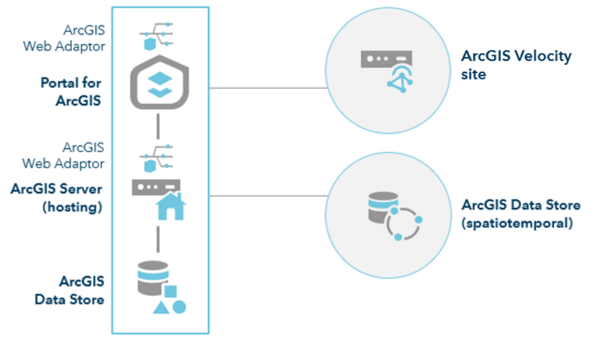

ArcGIS Velocity Server
ArcGIS Velocity is the real-time processing and analysis capability of ArcGIS Enterprise. It allows you to import, visualize, analyze, store, and use data from Internet of Things (IoT) sensors. High-velocity event data can be filtered, processed, and sent to multiple destinations, allowing you to connect virtually any type of streaming data and automatically alert personnel when specified conditions occur. You can also design analytic models to process high-volume data and gain insights into patterns, trends, and anomalies.
- Learn more about ArcGIS Velocity system requirements.

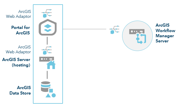

ArcGIS Workflow Manager Server
ArcGIS Workflow Manager Server is a scalable workflow management system that automates and simplifies many aspects of performing and managing GIS and non-GIS work in your organization. It includes a web app that is integrated with ArcGIS Enterprise.
An ArcGIS Workflow Manager Server site is configured and federated with an ArcGIS Enterprise deployment. An instance of ArcGIS Web Adaptor is deployed and configured for the ArcGIS Workflow Manager Server site. ArcGIS Workflow Manager Server can be installed on its own machine or on the same machine as the hosting server.
- See an Introduction to ArcGIS Workflow Manager for additional details.
