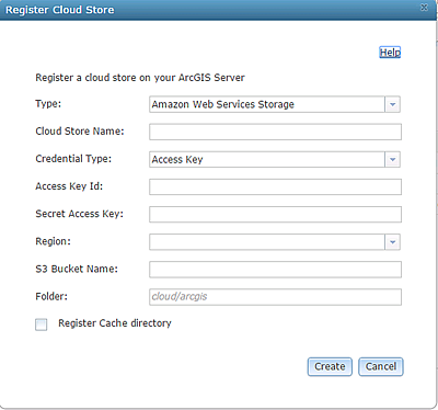

    2. To use a cloud store, provide the access key, secret access key, region, and bucket name. The cloud store settings include subfolder support.
      Register Cloud Store
      Note:
      To use a cloud store as a raster store, the ArcGIS Server account user must have read, write, and delete permission on the cloud bucket to properly manage the data.
