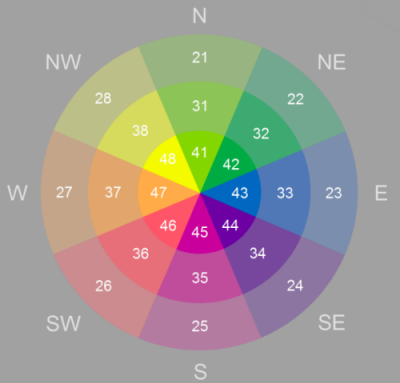

Aspect directions are shown.

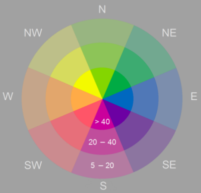

Aspect directions are represented by color, and the slope is represented by brightness. The slope values are in degrees, where the gray areas show slopes less than 5 degrees.
Notes
The pixel values in the output aspect-slope raster reflect a combination of aspect and slope. Pixels with values below 20 are considered flat and are shown in gray. Aspect-slope values of 21 and above will be displayed with varying saturations as follows:
  • 21 to 30—Low slope saturation
  • 31 to 40—Moderate slope saturation
  • 41 and above—High slope saturation
Aspect and slope color wheel
