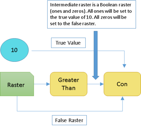

Sets the pixels of the output raster based on an if\else evaluation of each input pixel. It returns pixel values from the True Raster if the conditional evaluation is true (1) or returns the pixel values from the False Raster if the conditional evaluation is false (0). This criteria is specified by the output of a logical math function, which will be the input Raster.
The Con function must be preceded by a Math: Logical function, such as the Greater Than function. The output from the logical function is a Boolean raster (values of 1 and 0). When using the Con function, all values of 1 will be set to the True Raster and all values of 0 will be set to the False Raster values.
