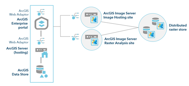

A raster analytics deployment is composed of three main components: ArcGIS Enterprise; a raster analysis site, based on ArcGIS Image Server; and an image hosting site, including raster data store, based on ArcGIS Image Server.
Raster analysis requires an ArcGIS Enterprise base deployment, which provides software and user interfaces to organize and manage processing, storage, and sharing of raster and feature data, maps, and other geographic information on a variety of devices. This integrated system manages the dissemination of processing and storage of results on-premises and behind the firewall, in cloud processing and storage environments, or a combination of both environments.
The ideal deployment of raster analytics is composed of three server sites to perform the primary roles of the image hosting site, raster analysis site, and hosting server site. In this ideal deployment, we need two ArcGIS Image Server licenses, one for the image hosting server and one for the raster analysis server.
ArcGIS Enterprise with Raster Analytics deployment
The advantage of configuring raster analysis with distinct server roles is to maximize efficiency and productivity. Separating distributed raster analysis processing and image service hosting roles enables resources to be dedicated to specific tasks without interruption. In this way, multiple users requesting access to various raster products and services do not compete for and impact raster analysis and image processing resources.

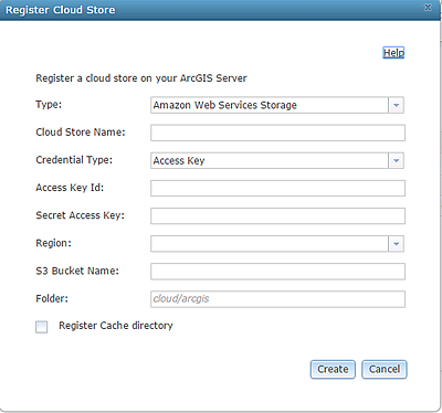

    2. To use a cloud store, provide the access key, secret access key, region, and bucket name. The cloud store settings include subfolder support.
      Register Cloud Store
      Note:
      To use a cloud store as a raster store, the ArcGIS Server account user must have read, write, and delete permission on the cloud bucket to properly manage the data.
