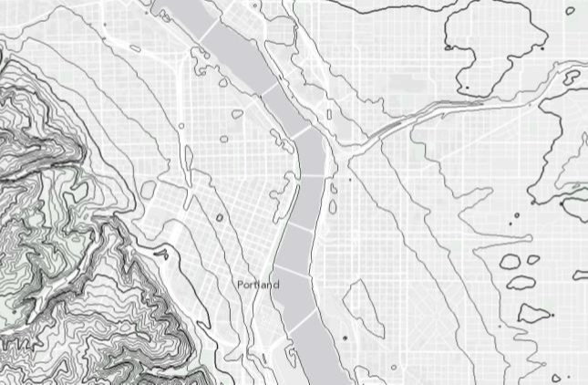

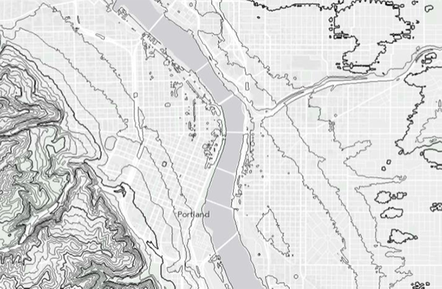

A key feature of the Contour function is the ability to generate cartographically enhanced contours in which jagged artifacts are removed. With the increased availability of accurate and high resolution elevation sources, contours generated from these sources often contain very jagged artifacts.
The examples below illustrate the effect of smoothing, The first example has no smoothing applied, while the contours in the second example have been smoothed using adaptive filtering. The smoothed contours are much more cartographically pleasing, while still correct.
Contours with no smoothing applied
Contours with adaptive smoothing applied
Contours are typically smoothed when producing cartographic products. The smoothing needs to represent the terrain as accurately as possible, especially when variable terrain includes flat and steep areas, and abrupt changes in topography. It is, therefore, not suitable to simply apply a median smoothing filter over the terrain. Smoothing contours lines accurately is a complex and time consuming process, and the Contour function employs an adaptive smooth algorithm to the digital elevation model (DEM) prior to contour generation. The smoothing can be considered a form of median filter that changes in size depending on slope. Flatter areas are smoothed more than steeper areas so that jagged artifacts are removed from flatter areas while maintaining required details with increasing slope. The result of the adaptive filtering is that streams, ridges, hill tops, and other important physiographic features remain well represented.

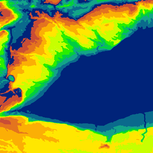

Filled contours
The function also has an option for generating filled contour regions. Essentially, instead of the space between contours being NoData, they are filled with a value that represents the quantized elevation value. The filled contours can also be combined with the Sigma Gaussian adaptive smoothing filter.
Space between contours filled with the elevation quantized value and displayed with a color ramp
