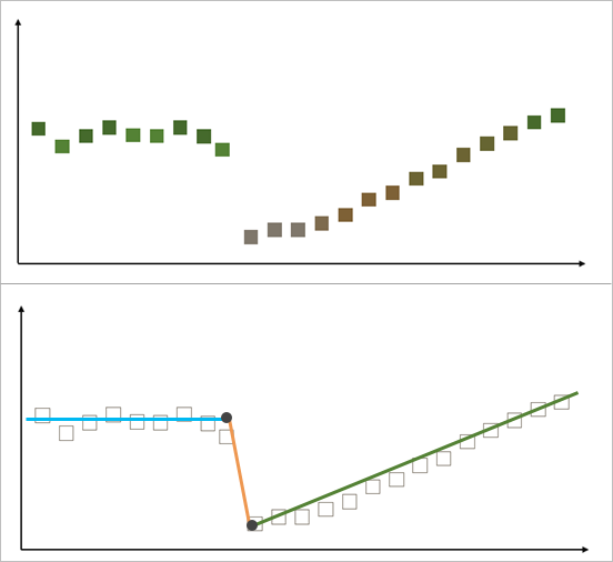

The LandTrendr algorithm is founded on the idea that a pixel's history can be broken down into several linear segments over time. There may be long periods with very little change, represented by a straight line with little slope. When disturbance occurs, the pixel's value will experience a change, represented by a short, possibly steeply sloped line segment. If recovery is allowed to occur, for example, after a forest fire, this will be represented by a long, gently sloping line, moving back toward the pixel's original value.
Two graphs showing a pixel value changing over time (above) and the segments fitted to those changes (below) using the LandTrendr algorithm
In the graph above, a pixel was green for some time, then a disturbance occurred and the pixel changed to a gray-brown color, then slowly shifted back to green over time. In the LandTrendr algorithm, this is represented by three linear segments shown in the graph at the bottom of the image. There are vertices at each change that help describe the segments.
This example is a highly simplified history for a pixel over time. There may be many changes to a landscape over the years, large and small. The Analyze Changes Using LandTrendr tool provides parameters to control the model information that is extracted, so that you only retrieve the changes you are interested in.

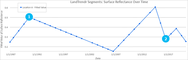

To explore the segmented results of the model, generate a temporal profile chart for the change analysis output from the Analyze Changes Using LandTrendr tool, using the Fitted Value band.
Temporal profile chart generated on the output from the
Date of change
To extract information about the dates at which pixel values changed, use the Detect Change Using Change Analysis Raster tool. This tool generates a raster in which each pixel has a date value corresponding to the date you are interested in. You can extract the beginning date or end date of a particular segment in the model. For example, you can extract the beginning date of the segment that represents the longest period of change, represented by point in the chart above, or you can extract the end date of the segment that represents the fastest change (highest slope value), represented by point in the chart above.
