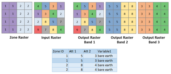

The Rasterize Attributes function enriches a raster by adding bands derived from values of specified attributes, from an external table, or from a feature service.
You can optionally specify a zone raster and the associated zone ID attribute to enable regional lookups.
Zone raster, input raster, output band 1, output band 2, output band 3, and a zonal attributes table

An optional single-band raster where each pixel contains the zone ID associated with the location. The zone ID is used for looking up rows in the zonal attributes table for zone-specific ingestion.
Leave this parameter unspecified if you only want to import the attribute.
Zonal Attributes Table
The zonal attributes specified as a path to a local feature class, the path to a table, the URL to a feature service layer, or a JSON string.
In JSON, it is described as a collection of mapping from zone IDs to an array of integers. { zoneId:[f1,f2,...,fn], ... }

If you were using the table above as an example, the query would be Variable1 = 'bare earth'.
