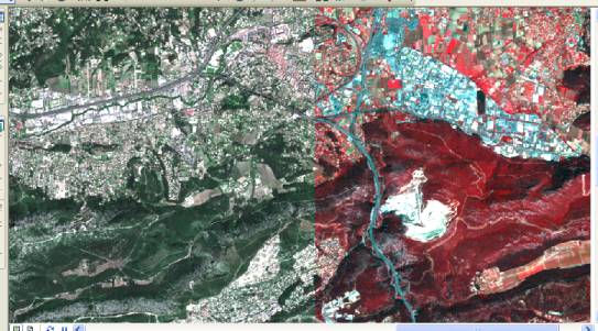

The following image uses a SPOTView ORTHO Basic image with four bands. The first three bands are displayed, creating an infrared image on the right side. Using the Spectral Conversion function with the matrix above, this image can be converted to a true-color image as shown on the left side.
Spectral Conversion function example
