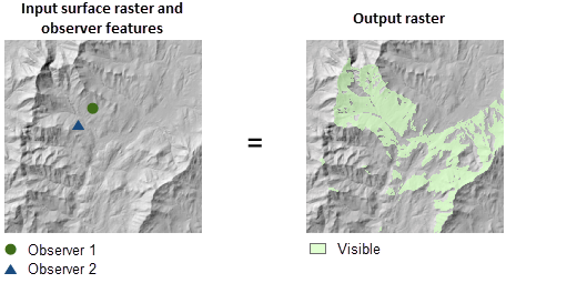

Viewshed with Frequency option illustration
Viewshed output with the Frequency option, displayed on a hillshaded elevation surface

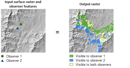

Viewshed with Observers option illustration
Viewshed output with the Observers option, displayed on a hillshaded elevation surface
