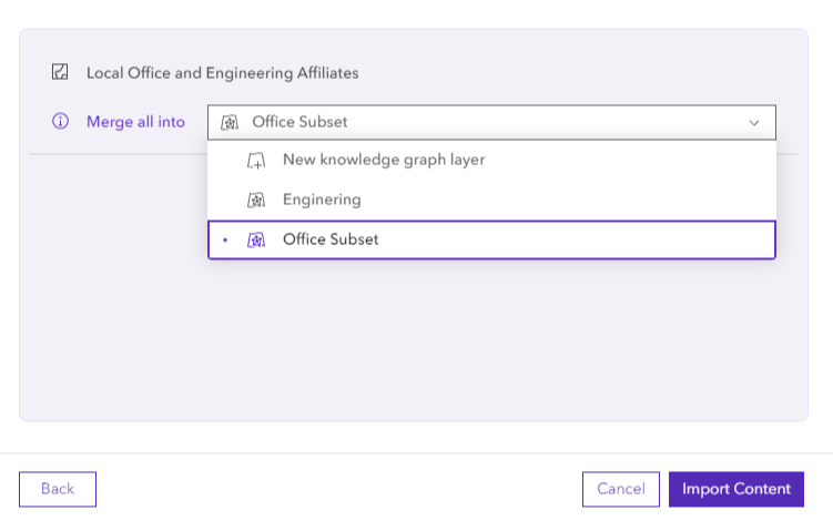

  5. Optionally, choose how these layers will be merged:
    • Express Import automatically merges all knowledge graph layers referencing the project's knowledge graph into a single knowledge graph layer for each map.
    • Advanced import allows you to decide which of the knowledge graph layers referencing the project's knowledge graph the others are merged into. The layer definitions for the selected layer will be used for the knowledge graph layer in this map. Optionally, create a knowledge graph layer; all layer definitions will be discarded.
    Advanced import layer merging for maps with multiple knowledge graph layers that reference the same knowledge graph as the project
